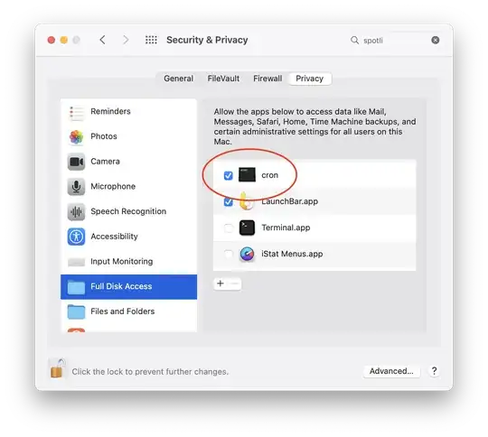

If you're not committed to using LaunchAgent, a simpler option is to run your script from your crontab, and add /usr/sbin/cron to System PreferencesSecurity & PrivacyPrivacy tab → Full Disk Access:
Screenshot of Security & Privacy preference pane
On macOS 12.1, this gives my backup script (run from cron) full access to everything in my user's home directory.
I believe this is still secure because commands executed by cron have to be added by you (the crontab files in /usr/lib/cron/tabs/ are protected by SIP). When I edit my crontab (via crontab -e) the OS prompts me if I give permission for the changes to be applied.
If you want to execute your backup script manually, in the terminal, you may have to add Terminal.app (or iTerm.app et al) to the Full Disk Access pane. This seems less secure because any command run in the terminal would then have full access to your disk (I would appreciate if anyone can confirm this).
