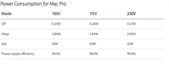

Mac Pro Power Efficiency
Apple puts out an excellent document (PDF) on the efficiency of the Mac Pro. But specifically, it get a 90% power efficiency rating at 100V, 115V and 230V which far exceeds the 85% minimum threshold set by the EPA to be Energy Star v6.0 compliant
From EPA Energy Start requirements:
Internal power supplies: 85% minimum efficiency at 50% of rated output, 82% minimum efficiency at 20% and 100% of rated output, with Power Factor > 0.9 at 100% of rated output for power supplies with >= 75W output power
