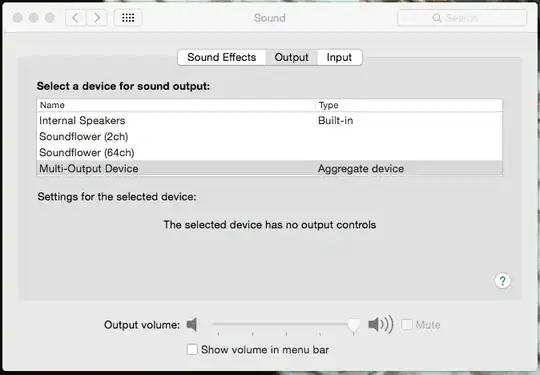

Now that the Soundflowerbed app is retired, I haven't been able to record my Mac's system audio :( Following the instructions from mattingalls' Soundflower-2 installation guide, (https://github.com/mattingalls/Soundflower/releases/tag/2.0b2), I rebooted, and then created a Multi-Output Device in Audio MIDI Setup, to be able to listen to the audio through the built-in speakers along with sending it through Soundflower 2CH, But I'm getting a super low audio volume when I try to record through Quicktime 10.4. Even with the volume cranked, there's very little sound in the Quicktime recording, and yes, I did make sure to adjust the volume before switching to the Multi-Output Device in Sys. Prefs.
Here's my setup: Audio MIDI Setup settings Sys. Prefs. Sound settings Quicktime Audio Recording input selection

enter image description hereI'm not sure if you've tried this, but the more important one is the volume you have routed to soundflower. To achieve a similar volume coming out of your speakers and still getting a louder recording, you'll have to lower the output volume and raise soundflower's volume.

I had the same problem. It appears the extension is in a funky state once it is installed. The sliders show 100% volume but its actually not. The easiest way to fix it is to go to the Audio Midi settings page and slide the master slider for Soundflower down and then back up for both input and output. This will solve the problem. Apparently it forces the internally stored values to reset.
