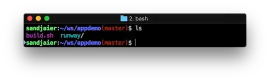

UPDATE: I switched to Oh my zsh a year back and it is awesome. My favourite theme is lambda-mod and my version of it.
Combining all the answers here is what I use:
COLOR_RED="\033[0;31m"
COLOR_YELLOW="\033[0;33m"
COLOR_GREEN="\033[0;32m"
COLOR_OCHRE="\033[38;5;95m"
COLOR_BLUE="\033[0;34m"
COLOR_WHITE="\033[0;37m"
COLOR_RESET="\033[0m"
#git_color
function git_color {
  local git_status="$(git status 2> /dev/null)"
  if [[ ! $git_status =~ "working directory clean" ]]; then
    echo -e $COLOR_RED
  elif [[ $git_status =~ "Your branch is ahead of" ]]; then
    echo -e $COLOR_YELLOW
  elif [[ $git_status =~ "nothing to commit" ]]; then
    echo -e $COLOR_GREEN
  else
    echo -e $COLOR_OCHRE
  fi
#git_branch
function git_branch {
  local on_branch="On branch ([^${IFS}]*)"
  local on_commit="HEAD detached at ([^${IFS}]*)"
  if [[ $git_status =~ $on_branch ]]; then
    local branch=${BASH_REMATCH[1]}
    echo "($branch)"
  elif [[ $git_status =~ $on_commit ]]; then
    local commit=${BASH_REMATCH[1]}
    echo "($commit)"
  fi
PS1='\[\033[01;32m\]\u\[\033[00m\]:\[\033[01;34m\]\w\[\033[00m\]'
PS1+="\[\$(git_color)\]"        # colors git status
PS1+="\$(git_branch)"           # prints current branch
PS1+="\[$COLOR_BLUE\]\[$COLOR_RESET\]\$ "
export PS1
export LC_ALL=en_US.UTF-8
export CLICOLOR=1
export LSCOLORS=gxBxhxDxfxhxhxhxhxcxcx
alias ls="ls -Gp"
