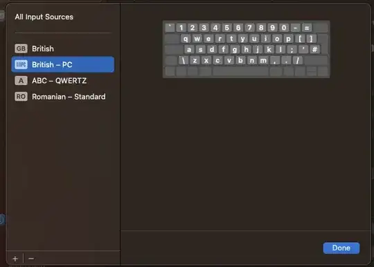

This is what worked for me with my Cherry KC1000 on Catalina: While connecting the keyboard, when asked about the key next to the left shift, skip the backslash key and press "Z" as if it was a regular US keyboard. On the next screen select international US ASCII keyboard. Now the British-PC layout will work as expected, along with backslash and backtick keys.
When you add the British - PC keyboard layout, before clicking Done, press the ~. The picture of the keyboard will transform the "\" character into a "`" character (see pic)
Screenshot of the Keyboard Settings with a British - PC keyboard layout
Now you can click Done.

  • You are talking about pressing the key next to 1, right? Like the answer just above yours? – Tom Gewecke Sep 29 '23 at 15:32
  • It makes no sense, but after trying all the other answers it was this answer that fixed it for me. I removed the plist file, restarted my Mac, connected my keyboard, went through the setup assistant again, looked at my input sources - but it still showed an ANSI layout. I then pressed the key between the shift and z keys and the layout magically changed to ISO. – FusionFox Jan 17 '24 at 23:48
  • @TomGewecke I think this is different - this answer is talking about pressing the key while just looking at the input sources list, not during the keyboard setup assistant. – FusionFox Jan 17 '24 at 23:54
  • Maybe this is a new variation of the issue in more recent versions of MacOS. I didn't try removing and re-adding the input source as suggested in another recent answer on this question, so I don't know if that would've also fixed it. – FusionFox Jan 17 '24 at 23:58
