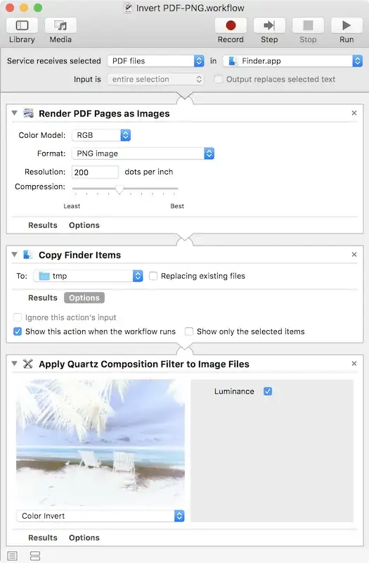

Here is a simple Automator Finder Service that will do what I understand you're trying to do. It will render PDF pages with 200 dpi as PNG images then invert colours in them.
Automator PDF service
You will notice that I left the Show this action when workflow runs turned on so you can specify the folder you want the PNG files to be in.
