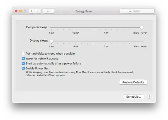

If you have your Mac mini go into "display sleep" after n minutes (System Preferences > Energy Saver), almost all TVs will automatically go into standby mode once they stop getting a video signal.
