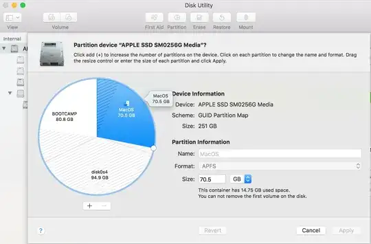

I have a MacBook 2015 running macOS High Sierra 10.13.4,I installed Windows 10 using Boot Camp. After that I created two partitions swap,root to do installed Linux Mint. Finally I installed rEFInd to manage the three OS's, but where reboot I can't access Windows. It's show message error "rEFInd - Booting OS Starting bootmgfw.efi Using load option '' BlInitializeLibrary failed 0xc00000bb ", How to fix it?

Are your partitions ordered 1. MacOS, 2. Windows, 3. Linux? Are your partitions all primary? – Scottmeup Apr 24 '18 at 08:19
Yes, That's right. – luctp Apr 24 '18 at 08:42
Could you run "diskutil list" from terminal and attach the output? – Scottmeup Apr 24 '18 at 09:44
Hi There, I fixed it, by disabling SIP, and converting MBR to GTP by "sudo gdisk / dev / disk0" , p,x,n,w,Y. Thank you for reply – luctp Apr 24 '18 at 10:23
@luctp Please add the above as an answer. – user7886229 Apr 24 '18 at 11:22
