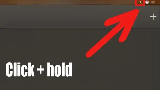

In my case, a display problem caused the spotlight input window to pop up off screen. Clicking and holding the spotlight icon in the system bar resets the location of the spotlight window and fixed my trouble.Spotlight icon
Chris
  • 584
    Worked perfectly for me. I had the issue where the Search pop-up would show on my laptop but would not when I plugged in an external monitor. When I unplugged then replugged the monitor it will still didn't work. Only this solution worked. Thank you! – Troy Sandal Jan 04 '23 at 16:39
    That's the only thing that actually worked for me. – Sandro Oct 23 '23 at 16:10
  • For those who don't have the spotlight icon in their menu bar, it's located in System Settings -> Control Center -> Menu Bar Only -> Spotlight. Then click the dropdown and select Show in Menu Bar. If its location in the settings changes in the future, you can always just search for Spotlight on the top left of settings. – Patrick Mar 15 '24 at 06:27

AFTER SOME DIGGING: Click and hold the Spotlight icon on the menu bar, until the Spotlight window has returned to its original location.
