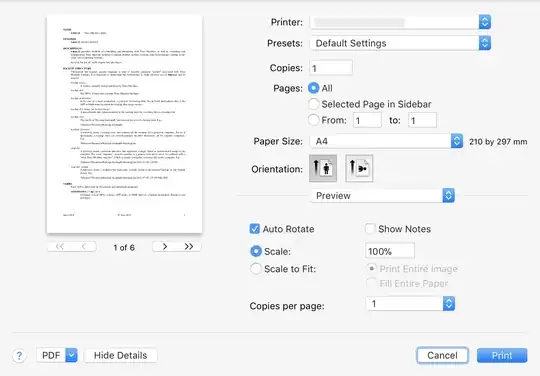

Is there a way to use the Terminal application to involve a viewer where I can search and/or print a man page?
man -t yourcommand | open -fa "Preview"
where yourcommand is the one you want the man page of. You can then use any of the normal search functionality in Preview and print the document as a normal PDF.

Typing just the command name in Terminal and then right-click on it and select Open man Page, displays it in a fully scrollable and searchable Terminal window, which is much better then typing e.g. man bash. You can also use the key combination P to print the contents.
