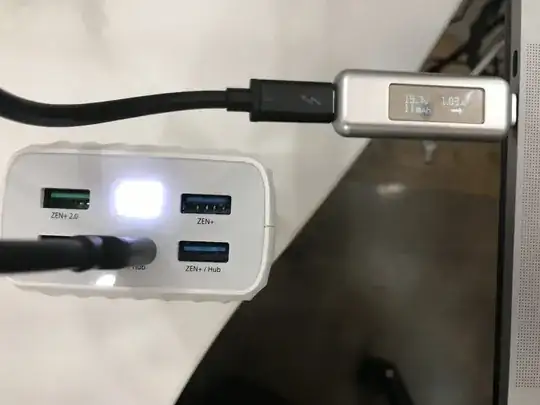

When I was charging my Macbook from a chunky Anker 26800 mah USB brick, it was like filling a swimming pool with a garden hose. So like yourself, I started investigating the power situation in respect to both cables and the USB brick.
To determine what "normal" performance was to establish a baseline, I used the Jokitech USB Type C PowerMeter tester connected to the USB-C/Thunderbolt Cable which was connected to the 87 Watt Apple Power Adapter that shipped with my Macbook Pro 2018.
The Jokitech revealed that 19.8v was the baseline I needed to measure the cables' performance against.
The meter proved my suspicions that the USB cable I was charging my Macbook from a USB powerbrick with WAS indeed a "garden hose": This cable was performing at barely 5v
I then swapped out the garden hose for the "FIRE HOSE" cable, a Anker USB-C to USB-C Thunderbolt 3.0 Fast Charging and Data Transfer Cable
Pictures of each cable will be shown first, followed by ones illustrating each cable's performance as displayed by the Jokitech meter while powering my MacBook using a Zendure X6 45 Watt Power Brick. As you'll see, the Jokitech made it possible to clear-up the question marks about where the weak link in the power chain lie:
"Garden Hose" Cable: Note USB 2.0 one end, USB-C on the other USB_2.0-to-USB-C Cable
"FIRE HOSE" Cable": Anker USB-C to USB-C Thunderbolt 3.0 Fast Charging and Data Transfer Cable
"Garden hose"* with a USB-C adapter: struggling to make 5v "Garden Hose" using a USB-C adaptor
"FIRE HOSE" cable performing at 19.7v: enter image description here
