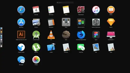

I normally tweak my iMac to the extremest way possible, including normally deleting useless system apps and certain processes and services. I did the same when I was running macOS High Sierra (10.13.0) and as soon as I updated to (10.13.1) all those system apps came back but only with greyed out icons and when being clicked they don't open because I have deleted supporting files and processes so now that these apps have come back, I am suspecting that the processes which I have deleted in the past might have also come back.
