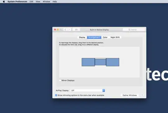

My problem: as soon as I lock my screen ... Monitor 2 will stay black. Meaning: I come back, I log into the system ... Monitor 1 works just as before. But Monitor 2 stays black. Although MacOs somehow still thinks the monitor is "there": when I turn to "displays" and look at "arrangement" - it shows all monitors. And windows that I "left" on the desktop space on monitor 2 won't show up on the other monitor.

I went to System Preferences -> Display -> Arrangement and toggled the Mirror Displays checkbox (ie check and then un-check it again).

  • This worked for me too, woohoo! – pfrank Mar 27 '20 at 15:06
  • This shouldn't be necessary, but it seems to work – Rob Feb 20 '21 at 00:34
  • Doesn't work. and the panel with mirror checkbox is in the black monitor. – towry May 07 '21 at 01:05
  • Quite scary if you accidentally mirror your primary black screen onto the still working screen! In the Displays tab > arrange... > I dragged my black laptop screen onto the working LCD I plug into to mirror, which gave me all black. Physically unplugging and replugging in the cable did not help. Was about to give up and hard reboot (ugh), but after locking the screen by dragging to a hot corner and waking it back up again, I was lucky enough to notice a cursor appear on black, and finally the mirror kick in. – qix Mar 27 '23 at 06:05
