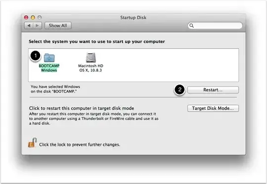

My final (and fatal) step was selecting the Windows disk in "Startup Disk" in System Preferences like so:
startup disk
...except it said "Untitled" instead of BOOTCAMP. Also not to confuse you, I am running 10.12.3 and did not install Bootcamp.
