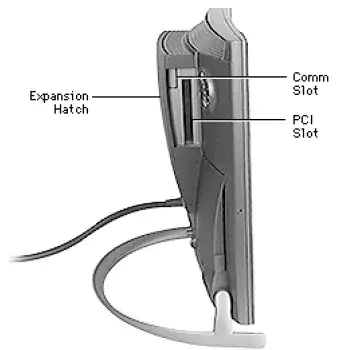

On the rear and side are some ports I'm not familiar with. I wonder if anyone can explain them?
The rear has 6 ports and I don't know what ports 3, 4, and 5 are for? There's also a large port on the left hand side that I'm not familiar with.

Actually, there are more than six ports on the rear, there's also a cover you can open to reveal a whole heap of other ports (e.g. Serial ports, ADB port, etc).
However, to explain the ports in your question:
  • Port 3 is a SCSI port
  • Port 4 is a TV Tuner port
  • Port 5 is a FM radio port
  • the port on the left side you refer to is a PCI slot (Note there's actually a comm slot above this as well).
Below are some images I've taken from the Twentieth Anniversary Mac Service Source:
