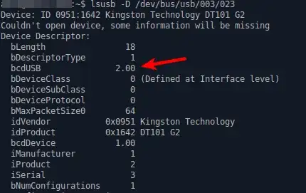

Neither 1) System Information, 2) ioreg -p IOUSB -w0 -l, 3) system_profiler SPUSBDataType nor 4) jlhonora's "lsusb" for macOS (brew update && brew tap jlhonora/lsusb && brew install lsusb) tell me which kind of USB device is attached like the Linux command lsusb:
DESCRIPTION lsusb is a utility for displaying information about USB buses in the system and the devices connected to them.
Use case: I want to know what kind of USB device is attached (e.g. USB 2 or 3) - not which type of port the device is connected to. Per this answer on askubuntu:
USB ?
