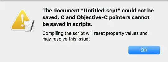

However, when I try to save my .scpt file in Script Editor.app, I am given the following message:
The dialog reads:
The document “Untitled.scpt” could not be saved. C and Objective-C pointers cannot be saved in scripts.
Compiling the script will reset property values and may resolve this issue.
I don't know the meaning of "C and Objective-C pointers", so I don't understand the problem.
I can successfully run and compile the script. But, after I compile the script, I still cannot save the file; I still get the above error message.

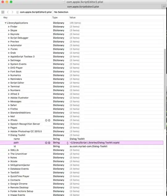

First thing I would try is opening up the scripteditor.app library panel. In Scripteditor go to menu item "Window/Library"
If dialog toolkit is present in the list, I would select it in the list and remove it. Then I would quit scripteditor.app and relaunch it again. Once scripteditor.app is up and running again, Open the Library panel and click on the “Add” button in the menu bar and navigate to ~/Library/Script Libraries and select Dialog Toolkit.scptd.
That will probably solve your problem. I have a funny feeling the problem is occurring because your new com.apple.ScriptEditor2.plist file probably does not contain any reference to the Dialog Toolkit.scptd as per this example in this image..
This is com.apple.ScriptEditor2.plist file opened in xcode
wch1zpink
  • 7,571
  • Can you please explain how to "open up the scripteditor.app library panel"? I don't understand how you arrived at the screenshot. – rubik's sphere May 28 '17 at 06:55
    Dialog Toolkit was not present in the Script Editor "Library" list, so I added it. I then relaunched Script Editor. But, when I went to save the .scpt file that contains Dialog Toolkit code, I still received the same error that I described in my post. I then opened my com.apple.ScriptEditor2.plist file in Xcode, and saw that it does contain the Dialog Toolkit library. However, I then deleted the Dialog Toolkit library in the Script Editor menu, and I immediately re-added it. I then compiled the script, and realized that now I can save the .scpt file without error. Thanks! – rubik's sphere May 28 '17 at 07:26
