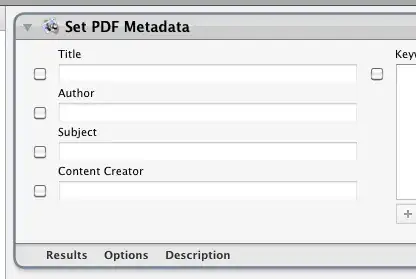

I suggest you google around those concepts. This is a good starting point. All in all, the idea of your script is to use the Automator’s action called: “Set PDF Metadata” (you could then put blank data on purpose):
Automator Action
If you create a PDF Service capable of replacing the default one, but that also sets the metadata to Blank, you’ve won.
