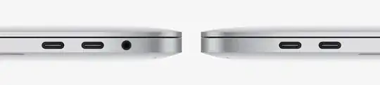

Apple's controversial decision to convert all the ports on their 2016 MacBook Pro lineup to USB-C ports contributes to blur the difference between ports that supply power (such as a power adapters) and ports that can power external devices (such as USB keys, mice or other gadgets).
This made me think about the following scenario: you sit at a table where your laptop is plugged in on the right, and don't notice that it is plugged in, so you decide to charge it with a second nearby charger that is laying around (i.e. belonging to someone who lives with you and who recently sat at the same spot).
What would happen then?
Would the computer charge twice as fast, would one of the chargers be dismissed by the system (which one?), or would it generate a surcharge that would destroy the computer?
I couldn't find anything about this online, but since I am always trying to force a USB in the MagSafe charger of my MacBook Air, I think that I could easily end up making this kind of mistake.
Note: My question asks what happens when two chargers are inserted into a MacBook Pro, but I am also wondering what would happend if 3, or 4 chargers were inserted. Although this scenario is unlikely to happen by mistake, it would constitute an obvious vulnerability to an exposed device, i.e. in a public space.
