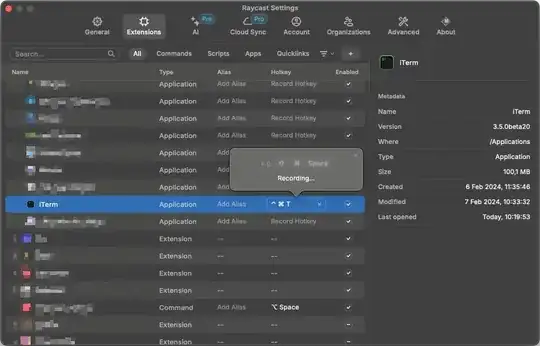

Raycast
If you use Raycast, you can go to Settings > Extensions and find iTerm in the Applications folder or by searching for it. Then add a shortcut:
