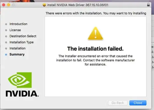

I am fairly competent with computers, but I've run into a problem that has me completely stumped. I have an Nvidia Quadro K1200 graphics card in my Mac Pro tower. I have used the Nvidia drivers with no problems, up until a few weeks ago, when Apple released the security update for OS X 10.11. When I tried installing the new driver, it gave me an error. I have now gotten this error in both OS X 10.11 and macOS 10.12, with both driver versions 346.03.15f03 and 367.15.10.05f01. The error appears after running through the whole install dialogue:

  • I think it is a problem with SIP, try disabling it http://apple.stackexchange.com/questions/208478/how-do-i-disable-system-integrity-protection-sip-aka-rootless-on-os-x-10-11 (P.S. do that at your own risk, always keep a backup) – Tom Shen Oct 01 '16 at 05:16
  • I thought about that, but it doesn't explain why I was able to install all of the updates until these... Thanks for the comment. I'll try it and see how it goes – NoahL Oct 01 '16 at 05:31
  • It is definitely System Integrity Protection (SIP), but NVIDIA signs their drivers. I would not suggest disabling SIP. Have you tried completely uninstalling the prior drivers and then trying to install the new drivers? I know there were problems with certain versions of the drivers when the security update was released, but NVIDIA's updates since then should have resolved them. – tubedogg Oct 01 '16 at 05:34
  • @tubedogg yes I have tried deleting all drivers and associated files/logs and reinstalling, but to no avail. I'm going to try disabling SIP and then retry the install – NoahL Oct 01 '16 at 06:12
I will answer my own question. Thanks to the help of the fabulous commenters, I managed to disable System Integrity Protection (SIP) and install the driver. However, because I couldn't see the screen I had a bit of trouble. I booted the Mac Pro into target disk mode, then took an Apple laptop and used a FireWire -> thunderbolt cable to connect the two. I booted the laptop holding down the alt key. I selected the Mac Pro's recovery partition and booted into that. I disabled SIP in there. However because SIP is hardware specific, I had to change the laptop's startup disk to the one from the Mac Pro. I let it reboot, then installed the driver and shut off both computers. I booted both the laptop and Mac Pro up. The Mac Pro had installed the driver and still had SIP enabled. The laptop rebooted from its internal SSD. I hope this helps someone else!
