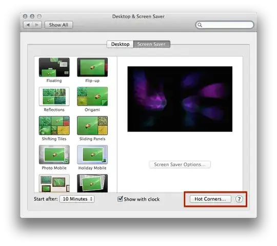

2. Use Hot Corners to lock your screen
First, go to your System Settings -> Desktop & Screen Saver and choose Hot Corners on the bottom right.
Next, choose one of the corners the option Put Display to Sleep. I prefer bottom right, but this is by each user different.
That's all. One note: You can configure in the Privacy Settings when the display will be locked. For example, if you have it set to five minutes, you need to enter your password after the time in your setting is gone. You can change this to immediately, for example.

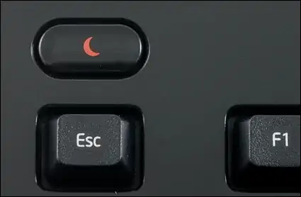

Hold down the power button for about a half second. This will sleep the computer. If you have it set to lock when the computer sleeps, you're good to go. However, if you hold it down too long, it will ask to restart the computer.
Edit: As ingenious stated, some keyboards do not have a power button. In that case, attempt to locate a sleep button or try another method.
Sleep button
(source: andrels.com)
