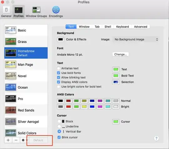

In preferences, go to the Profiles tab. Click on the profile of your choice('Homebrew' in this case). Click on default at the bottom. This will load the same profile when you open it the second time after closing the terminal. Screenshot below.

  • I already mentioned in my question that I set it as my default. The problem with selecting Homebrew as my default profile is that once I close the first window that opens, the next window I open will be in the Basic profile. iTerm2 seems to be a good permanent solution. – slightly_toasted Mar 28 '16 at 15:27
  • That means you did not set it as your default, you only set it to be used for the first window opened at startup. See https://apple.stackexchange.com/a/328339/6883 – Chris Page May 03 '20 at 12:04
