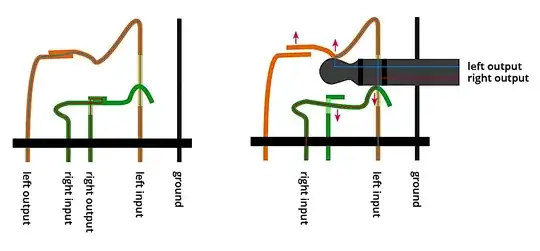

The circuits involved giving the system the 'wrong info' about 'what's going on in the port' look somewhat like this:
Meaning: with a regular jack inserted, internal speakers are muted, but sound signals are going out via line. But without a jack inserted, the system lacks the electric contact, the switch is stuck, and the system therefore assumes 'optical-out present', mutes the internal speakers, and sends out the light into the room.
