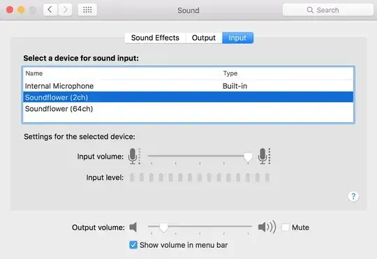

Step 1
After installation, a new device will be available in System Preferences > Sound. Go to the Input tab and select Soundflower (2ch) as the input device.
Audio Input Tab
