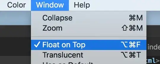

I am using the built-in Stickies app. I've created a sticky for each space on the top left corner. Just set the sticky window to Floating which keeps it on top of every other window.
This way you get a nice label for each Space which is visible while you are working.
To see all your Spaces just select the Stickies app, click Control + and you see the stickies in a row which represent your Spaces and also clickable:
Plus desktop can be selected from a list as asgardian07's answer shows.
