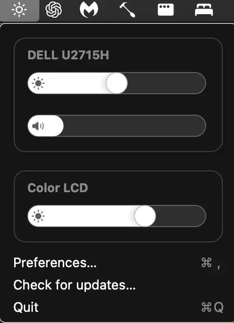

Knowing that this question is rather old I want to make you aware of https://github.com/the0neyouseek/MonitorControl which is open source, well maintained and quite handy.
enter image description here enter image description here enter image description here
You can control brightness, contrast or volume directly from a menulet or with keyboard native keys. Keyboard keys even display the native osd.
