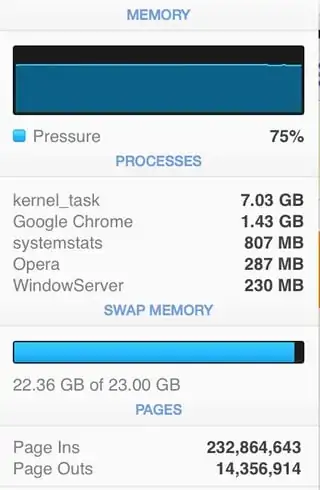

After checking on memory, it seems kernel task ate 7GB and 22.36GB swap memory was used of total 23GB (which obviously was the case). However I've still 20GB of space free on my SDD.
Memory - iStat Menus - screenshot

My top stats before my kernel freeze:
Processes: 344 total, 2 running, 5 stuck, 337 sleeping, 2580 threads                                                                                                                         19:23:56
Load Avg: 1.56, 1.62, 2.09  CPU usage: 3.51% user, 8.47% sys, 88.1% idle   SharedLibs: 46M resident, 0B data, 6572K linkedit. MemRegions: 757970 total, 2139M resident, 56M private, 907M shared.
PhysMem: 9410M used (6198M wired), 556M unused. VM: 1155G vsize, 1311M framework vsize, 112872658(320) swapins, 122668389(0) swapouts. Networks: packets: 299419263/363G in, 142126838/14G out.
Disks: 58970173/1079G read, 20012389/1120G written.
