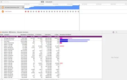

It's SIGKILLed. It's hard to tell it's OOM on macOS since when you tail -f /var/log/system.log
 Jan 14 10:46:39 ... com.apple.xpc.launchd[1] (com.apple.mdworker.shared.10000000-0000-0000-0000-000000000000[41845]):           Service exited due to SIGKILL | sent by mds[72]
The error message doesn't help.
Then I tried Instrument shipped with macOS,
And attach instrument to your Python process. You can see the memory goes unbounded until it's killed.
