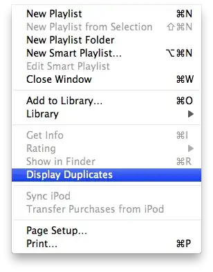

You can use the default iTunes engine to find duplicates :
File > Display Duplicates
duplicates
Or, use a third-party software like TuneUp or TidySongs.
