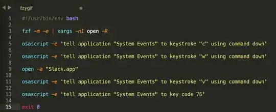

I'm only 11 years late but I think I have an alternative, albeit, hacky solution. Here's my script:
#!/usr/bin/env bash
fzf -m -e | xargs -n1 open -R
osascript -e 'tell application "System Events" to keystroke "c" using command down'
osascript -e 'tell application "System Events" to keystroke "w" using command down'
open -a "Slack.app"
osascript -e 'tell application "System Events" to keystroke "v" using command down'
osascript -e 'tell application "System Events" to key code 76'
exit 0
A few disclaimers:
  • This assumes a macOS environment.
  • In the script, I'm using a command line tool called fzf which is not needed. It just makes searching for things easier. You can get it from brew install fzf if you're interested.
  • My use case was to find a way to search, find and send gifs quickly in Slack. So I named it 'fzygif'.
fzygif.png (The following description references the line numbers in the image above:)
  • Line no. 3 - fzf -m -e is to allow for multiple files to be selected as well as to search using the exact term used. The result is then piped into xargs -n1 open -R which then applies the open command to each search result, one at a time.
  • Line no. 5 - Next I use the osascript -e command to simulate Cmd+C which is the Apple keyboard shortcut for Copy.
  • Line no. 7 - Next I use the osascript -e command to simulate Cmd+W which is the Apple keyboard shortcut for Close Window (just doing a little housekeeping along the way; this could be omitted).
  • Line no. 9 - Next I open Slack (the intended target for my recently copied gif; open whatever app tickles you).
  • Line no. 11 - Next I use the osascript -e command to simulate Cmd+V which is the Apple keyboard shortcut for Paste.
  • Line no. 13 - Lastly, I use the osascript -e command to simulate "key code 76" which is the Apple key code for Enter. This is to automatically send the gif in Slack after it's pasted (this too could be omitted).

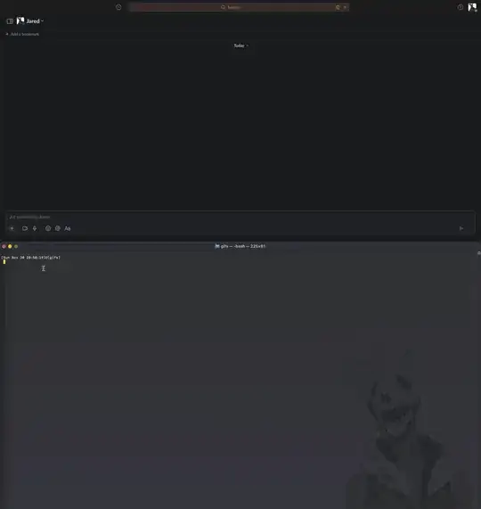

Since a gif is worth a thousand words? Here it is in action:
Happy hacking!
