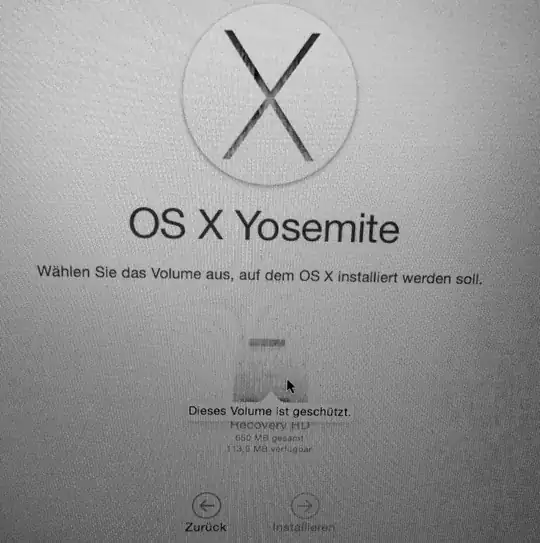

I wanted to have a clean Yosemite installation. Therefor I deleted the existing partition to make sure a completely clean installation is made. The problem is that I cannot choose the partition to install to any more. After accepting the license there is no partition to select from. Except for the recovery partition itself. Macintosh HD is still there in the partition tool. but I cannot select it or rework it in any way because all options are greyed out.
Tried booting via recovery partition and stick.
How do I get back to having a partition to install to?
screenshot from partition tool enter image description here
  • Dieses Volume is geschützt = it is locked/protected, and you can not use the Recovery Partition anyway for that. – Ruskes Oct 26 '14 at 00:47
  • Can you post the results of running "diskutil list" in the terminal? And also "diskutil cs list" – Chris A Oct 26 '14 at 02:20
  • I had a similar problem when install Yosemite, due to the disk being converted to a Logical Volume Group, or "Logische Volumegruppe" as you'll see there. – Chris A Oct 26 '14 at 02:28
  • One more thing: will Disk Utility let you verify/repair the disk in the "first aid" tab? – Chris A Oct 26 '14 at 02:35
  • @ChrisA I can check the drive and received no indication something is wrong. It does not attempt to repair anything. How can I post it? It is a long list to type off... Any alternative to get it? – RogerWilco77 Oct 26 '14 at 09:23
  • @Buscar웃 you are right, but why is the other partition not shown? Well, I cancelled a previous installation where the drive was being encrypted. But I did it the soft way. Not by switching the MacBook off. So I see no reason the drive is not there. – RogerWilco77 Oct 26 '14 at 09:27
  • I am trying to install to a stick now.... Will take a long time. Last night it failed. Something is wrong with the install stick I created. But I tried installing from recovery with same result anyway – RogerWilco77 Oct 26 '14 at 09:34
