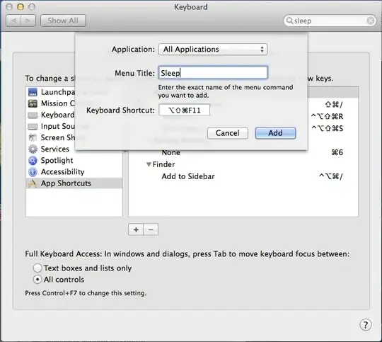

Not sure it's an exact answer to your question, but how about a Hot Corner to put it to Sleep?
Sleep Hot Corner image
... or add a key command...
Key Command
Tetsujin
  • 115,663
    Thanks, but this is not easier than pressing the power button shortly. I really want to close only the lid to initiate sleep. :/ – gklka Oct 24 '14 at 19:15
  • No worries - my Mac Pro doesn't have a lid, so for me, swiping to the bottom left corner with the mouse is by far the fastest. – Tetsujin Oct 24 '14 at 19:17
