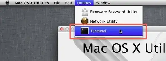

Internet Recovery
Boot to Internet Recovery (hold Cmd+Opt+R during startup), so that the disk will not be in use. If your machine is too old for Internet Recovery, you should be able to boot from another disk (not another partition) and get the same result. Note: in this case that the disk numbers (/dev/disk0) may be different for you.
Start Internet Recovery, and go to Utilities -> Terminal.
Internet Recovery terminal
