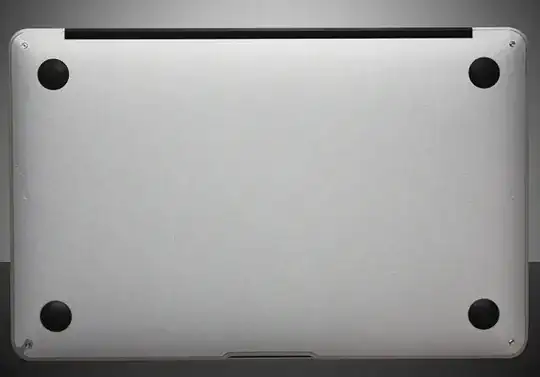

To replace the battery; it's actually very simple. Just remove the screws holding the back cover in place.
Back cover of MacBook Air

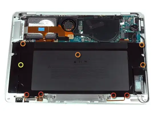

Then, just remove the screws holding in the battery and swap. Just be careful when disconnecting the battery from the logic board. Don't yank it off, use a spudger or similar tool to disconnect the molex connector by "wedging" it off.
MacBook Air back removed
Reverse the procedure to reassemble. Make sure you note where each screw comes from as they are different.
