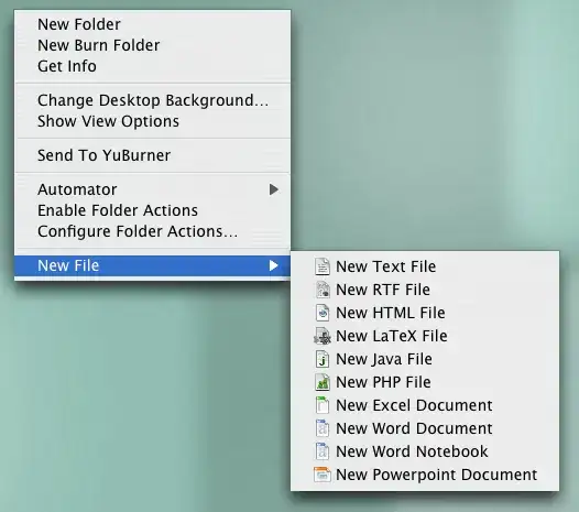

I myself Always used TextEdit for this job, open TextEdit and save blank page with desire extension in desire location.
Also you can use nufile (I didn't test myself)
Or use some applescript.

  • I wish! I don't think contextual items work in 10.6. This program didn't work for me, and I recall the Finder SVN plugin also cannot work in 10.6. –  Apr 16 '11 at 15:50
