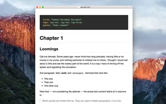

If you would like markdown to be read with Quick Look, you can use QLMarkdown.
You can install it either by:
- Download the
QLMarkdown.qlgenerator
in either~/Library/QuickLook
(current user) or/Library/QuickLook
(all users). - Using Homebrew, run
brew install --cask qlmarkdown
in the Terminal. (updated)
If you find qlmarkdown Applications, right click and open the app, it will get around the Apple security check warning.
After that, you should be able to view markdown files.

The new version of QLMarkdown is here now: https://github.com/sbarex/qlmarkdown – postylem Apr 04 '22 at 02:52
Error: `brew cask` is no longer a `brew` command. Use `brew <command> --cask` instead.
So the update to the command would be:
– ximbal Aug 21 '23 at 19:56$brew install --cask qlmarkdown

You might want to think about installing qlmarkdown which gives you the ability to preview MarkDown files properly in the Finder using QuickLook.
- 12,142
1The QLMarkdown project linked to seems to be abandoned, but there is a new QLMarkdown now at https://github.com/sbarex/qlmarkdown, which I can confirm works on macOS 12.3... – postylem Apr 04 '22 at 02:54

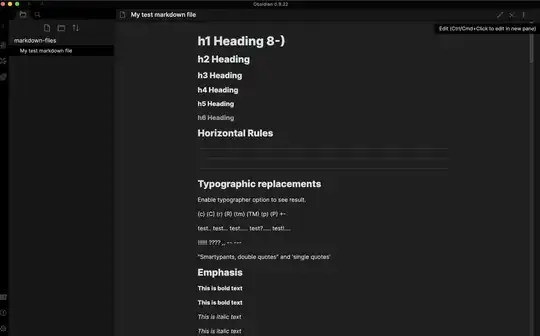

There is also a newish option called Obsidian - https://obsidian.md/, which more of a networked thought tool (like Roam Research) but build on top of markdown files.
- 1,070
Exactly what I was looking for: simple and easy to browse a folder structure with .md files! 10 000 thanks ! – Warnaud Mar 15 '21 at 08:07
This must be amongst the most underrated responses ever supplied on stack overflow. – Mark Hamlin Oct 27 '21 at 09:42
QuickLook
plug-in does not work withMavericks
. – Colas Feb 24 '14 at 12:56QLMarkdown.app
, which must be run to activate the plugin. This is what you get withbrew install --cask qlmarkdown
today, thankfully. – gimboland Feb 19 '22 at 13:40
