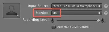

You can use GarageBand:
  1. Create a new project and choose for example the voice template
  2. Set Monitor to On
  3. Optionally remove the effects from the Edit tab
