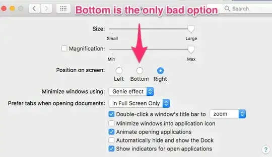

  • I couldn't get #1 to work... I answered below: putting dock on left or right works somehow...
    https://apple.stackexchange.com/a/284811/18875
    – Dan Rosenstark May 25 '17 at 14:37

    One tip: If you put the dock on the left or right, instead of the bottom, then it will only appear on your left-most or right-most arranged display. This way it will never be accidentally shown on the wrong display and the app switcher will always be in the right spot.

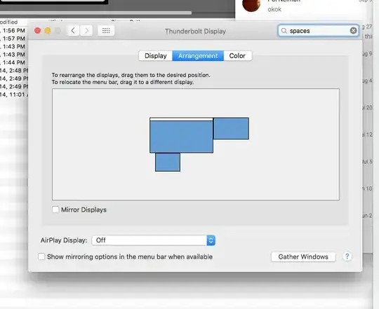

Duet Display & Arrangements with Strange Behavior
Another strange note is that if you have a Display that is seen below your primary display in the Arrangement View -- like this example using Duet -- it will get the Dock, and therefore the switcher. Move it to the side or above to avoid this.
    I had the same issue, although my secondary screen were on the left side. So did Dock. Moving Dock to the right side did the trick. – Darmen Amanbay Mar 04 '19 at 16:29
Edit
Just realized that I've been here before and it's just above! The answer is:
don't put the Duet "below" your other display in the arrangement!

The only workaround I have for now is to put the dock on the right or left. Very weird!
