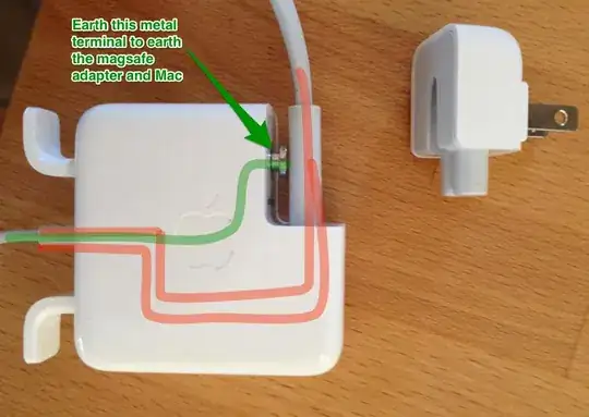

Rather than using a two prong plug, you could use a longer two prong cord and then ground the metal disc that serves to hold the "duck head" on the transformer/rectrifier/filter that makes up the bulk of the MagSafe adapter.
alternative solution to using the Apple duck head with the MagSafe adapter

  • Darn - I should have gotten a multimeter (or double checked tech manuals). Thanks for the correction @XAleXOwnZX - does anyone else see any problems with this now that I've edited out that wrong info? – bmike Aug 31 '13 at 20:01
The transformer is double insulated and thus does not require to be grounded. It's the same with your mobile charger and external hard-drive PSU.

The MagSafe Power cable can either put an extension cable or a plug on the 'brick'. I've noticed that if I only use the plug on the brick, then the aluminium case 'tingles' when I touch it.
If I use the extension cable on the brick, then the tingling is not present. The Apple plugs don't connect to the earth pin, but the extension cables do. See this answer.
