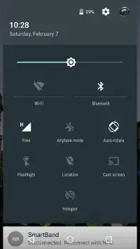

When I display the quick settings panel, there are shortcuts to enable some functions (wifi, data connection ...)
When my phone is locked (pin code), the location switch disappears, (for security reasons AFAIK).
But the airplane mode switch is ever displayed, so a thiefer could easily enable it, and disable location by the same.
Is there a way to disable the airplane mode switch when my phone is locked ?
Locked :
locked
Unlocked :
Unlocked

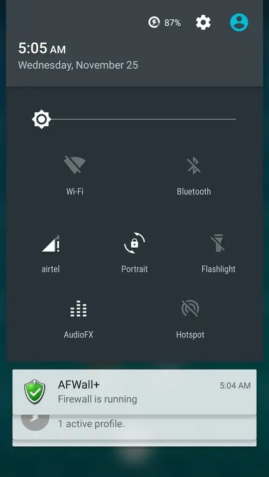

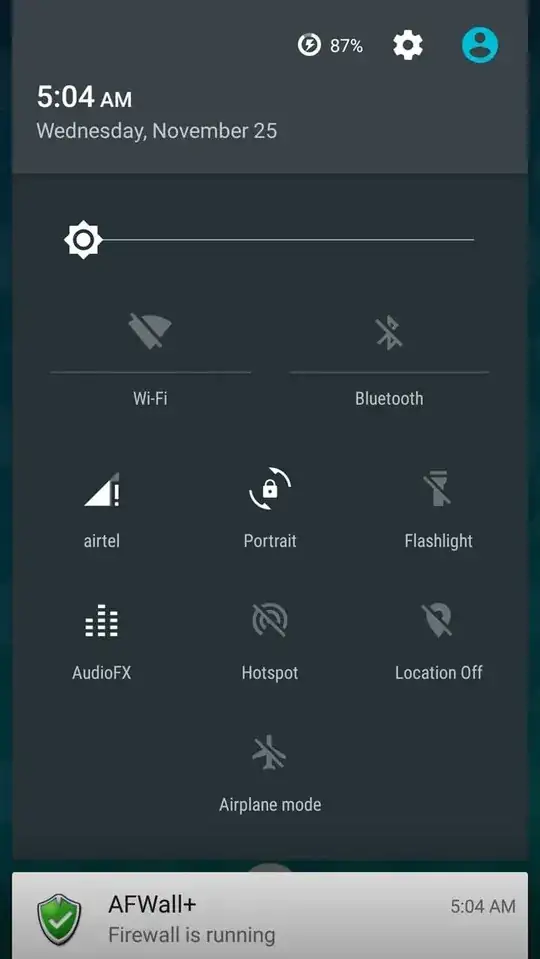

Screenshots
Order of images as "All tiles available when screen is unlocked" → "No Airplane tile when screen is locked"
(Click image to enlarge)
IMG: No tiles when screen is locked IMG: Tiles when screen is unlocked
