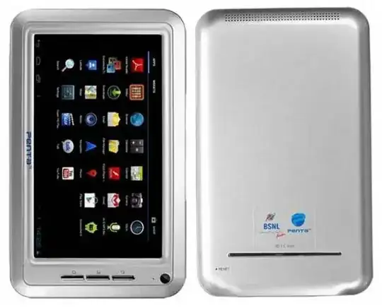

My BSNL penta IS709C tablet got locked after too many unlock attempts. After that I tried to hard reset by pressing BACK + HOME + MENU buttons together with the power button but in vain.
Tablet present condition:
1) USB debugging off, so no adb commands.
2) wifi is off.
3) No associated google account.
Please help me restore the tablet or suggest me how can I hard reset it.
BSNL IS709C

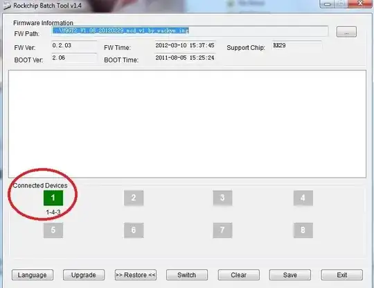

  • Now open the RKBatchTool provided here(..BSNL-IS709C\BSNL IS709C\Firmware\upgrade\tool). You will see a green color square on it which means that it has recognized your device. Meanwhile is the Chinese version, so can refer this picture for further operation:
  • Click on the Restore button to factory reset the tablet and when its done. Click on upgrade.
