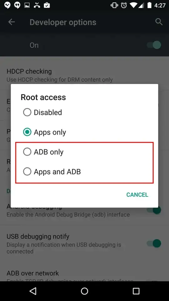

These settings are for CyanogenMod
In order to allow ADB root access, I go in to Settings => Developer Options. There you will see Root Access:
Root Access
This needs to be set to either ADB only or Apps and ADB.
Adb only / Apps and ADB
If this is not set, Droid Explorer will not be able to launch as root. When it tries to get the folders and files of certain directories, it will be denied.

    It works with CM 12! I wiped my Moto X and installed the latest official CM 12 nightly and I can access /data/data/ now. Hmm..... – Ben Jokisch Jan 20 '15 at 04:32
  • @BenJokisch yes, the downside to this, "stock" builds don't allow adb to run as root. It actually states "adbd cannot run as root in production builds". A plus, I have put in code that will notify users of the inability to launch adb as root, and direct them to this question. – Ryan Conrad Jan 20 '15 at 05:33
  • @BenJokisch I added some info about adbd insecure to my answer. That app should solve your adb root problem on NON-CM devices. – Ryan Conrad Mar 12 '15 at 01:13
    Yep, confirmed working on my 2nd-gen Moto X (stock 4.4) with adbd insecure installed. Thanks buddy! – Ben Jokisch Mar 13 '15 at 15:04
