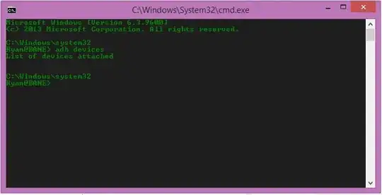

When the device is set to use MTP, neither Windows, nor ADB will detect the device when connect via USB cable. I have tried multiple cables, in multiple USB ports. I have not tried other computers yet, as this is the only one that actually has the driver installed.

MTP
adb devices - MTP

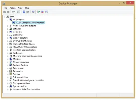

I opened up Device Manager. My first problem is I was looking for Android Composite ADB Interface, which is what it usually is called. I started looking harder. When I noticed ACER Device. My machine is not an ACER, nor do I have any ACER devices attached, or so I thought. I expanded that group and found ACER Composite ADB Interface.
These are the steps that I followed that got my ADB working with my device. YMMV.
  • Download the latest USB Driver from Google
  • I right clicked this device
  • Uninstall
    • You may need to reboot after. I did.

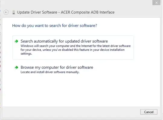

  • Selected Update Driver Software
  • Clicked on Browse my computer for driver software browse
  • Select the path to the drivers that you downloaded at the first step, check the "Include subfolders" Let me pick

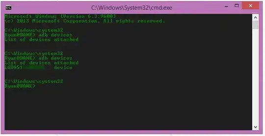

  • Finally run:
    adb devices
  • Profit! Success!!

  • This worked! And it was driving me crazy with the Nexus 6. Thanks! :) – leenephi Jan 05 '15 at 15:55
  • This worked for me too, but be sure to select the 'delete the old drivers' option when removing the Acer Composite ADB Interface, as it your PC will keep telling you it's an Acer device and won't let you assign new drivers. – ED-209 Mar 17 '15 at 13:53
