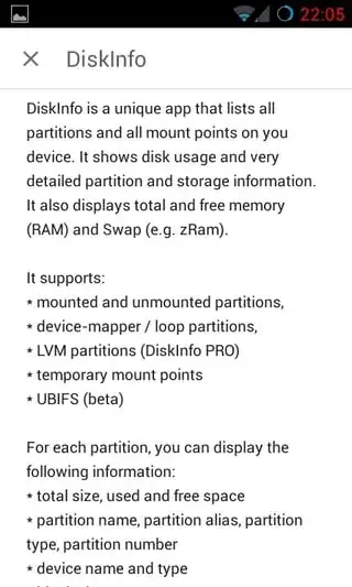

    That DiskInfo app will show you the unmounted recovery partition. I just checked, mine (HTC One V) is mmcblk0p21. Its pretty detailed for an app. – HasH_BrowN Dec 24 '14 at 17:45
  • That was the other answer :) Thanks, will check that. Might do as a work-around (when it's possible to install an app and evaluate that stuff manually). Just wondering: if an app can do that, there must be a place where those details are stored... – Izzy Dec 24 '14 at 17:47
    My sentiment, but where. Probably not listed/stored the way we're looking for. – HasH_BrowN Dec 24 '14 at 17:49
  • That was a gold comment! I should have phrased the question completely different. The easiest way is what one thinks of last... But re-phrasing it that way now would render your answers wrong. Guess I better ask that as a new question. Here or at SO, have to think that over. Developers might have better knowledge of that – but OTOH they might come up with Java code and system calls, which doesn't help me at all... Yuck: how to identify names of the partitions (but again, just for those curently mounted...) – Izzy Dec 24 '14 at 17:56
DiskInfo will be the app you want. It will show all mount points, plus all unmounted, and all temp partitions.
This is just a graphical interface, with no other real functionality. Perfect for your need. This does require to be used on fully booted device. Root is not needed.
Screenshot
Screenshot (click for larger variant)

HasH_BrowN
  • 2,500
    Sorry, absolutely no. You must have missed the command-line tag :) Guess I'll better write that explicitly. I know a number of apps showing these details, but I need to access/gather them via adb shell, and without the help of an additional app (cannot always first install that on a device handed to me). – Izzy Dec 24 '14 at 10:01
  • Ooops. It wont hurt my feelings, want me to delete this ( so no misdirection )? – HasH_BrowN Dec 24 '14 at 16:01
  • Only if you feel the need. Could be useful for someone else looking for the same details by "other means". Otherwise I had marked it "NAA" (not-an-answer) ;) I won't downvote it (it might give the requested details, I didn't check – does it show which partition holds what, as described in my question?) – but won't upvote/accept it either ;) – Izzy Dec 24 '14 at 16:57
  • Yes it will show what the partition is for (containing), it just wont show the actual contents. – HasH_BrowN Dec 24 '14 at 17:39
    That's fine, so from that point it matches! So please, do not delete this answer :) – Izzy Dec 24 '14 at 17:41
