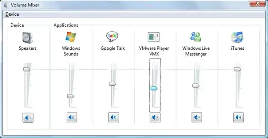

I want to use Spotify and a running speed tracker app at the same time, but Spotify is much louder than the other app and so I cannot hear it when both running simultaneously. Is there a way I can turn the volume down on one app but not the other, similar to volume mixer in Windows?
volume mixer
