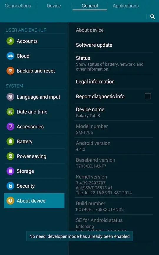

I'm having trouble enabling developer options on my Samsung Galaxy Tab S 8.4 tablet. I click the build number 7 times and get the toast telling me it's enabled, but it doesn't appear in the menu items.
dev opt not shown on the menu
As you can see, developer options are unlocked but it's not listed in the menu items.

  • Well, try hiding then To hide them, go to Settings>apps>swipe over to all apps>scroll down to settings storage>tap clear data.Once you hide, then again try tapping 7 times over the build number to activate them and see if that shows you the ??? – Peter Carlos Dec 23 '14 at 06:29
  • Based from Samsung's FAQ, you already did the correct procedure and it should appear under Settings > General > Developer options. Might be a silly question, but have you tried closing and opening the Settings again (maybe it needs to be refreshed)? – Andrew T. Dec 23 '14 at 06:37
  • Yes, I have restarted the tablet, ive restored it a few times and still it does not appear. – Mike Masters Dec 23 '14 at 06:45
  • Peter, I'm following your instructions but the clear data button is blank. – Mike Masters Dec 23 '14 at 06:49
  • Well, if clear data button is blank means no data is available to clear up ! Now that's weird ... – Peter Carlos Dec 23 '14 at 07:08

This is a bit of a desperate idea, but try rotating your device between portrait and landscape. It doesn't seem likely, but it's possible somebody at Samsung may have accidentally left out the Developer Options item from the layout or changed something that caused it to remain invisible.
If that doesn't work, try installing an app from the Play Store that acts as a shortcut to developer settings (like this one). It's not the most elegant solution, but it should be enough to get you there.

  • Thanks Cody, I tried the shortcut apps before and they didn't work, but was worth a shot! – Mike Masters Dec 23 '14 at 12:33
    That sounds like a bigger problem. If firing off an intent to the system to load Developer Options isn't working, it's not just an issue of the Settings app failing to show it in the list. You might want to go straight to Samsung's Support channels and report the issue officially. – Cody Toombs Dec 23 '14 at 12:47
