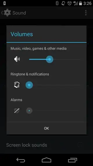

Edit: When I go to Settings > Sounds > Volumes, if the Ringtone & notifications volume is down, the "Alarms" volume is automatically turned off, and I can't change it. In fact the alarm icon even gets a cross through it. So it looks intentional, but I can't for the life of me work out why that would be desired behaviour.
Screenshot
Screenshot (click image for larger variant)

    I'm using AlarmDroid as alarm clock. This has a setting to "override alarm volume". Worth a try, I'd say – and please report back if that solves your issue, so I might make it a proper answer ;) – Izzy Nov 19 '14 at 14:40
  • It seems this is a new "feature" introduced some time last week. Everything used to be fine for me too, now I cannot change the alarm volume when the notifications are on silent or vibrate. This sucks even more because I want to make my phone silent so I can take the notifications on my pebble. – s-ol Jan 17 '15 at 19:21
