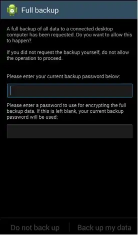

    ...and the following prompt on the phone:
    It makes no difference what I do here (details to follow).
  4. I tap the Back up my data button (bottom right corner).
  5. The phone returns to the home screen and shows me the Backup starting... message, then the Backup finished message a few seconds later. A 0-byte file is created, named either the default backup.ab or whatever I specified with the -f switch.

The "Full backup" password prompt (step 3):
I'm quite sure I have never set a backup password before. I've never had the occasion to set this password or access this setting in any way before. However, I have tried all of the following:
  • Leaving both passwords blank
  • Leaving the "current backup password" blank and entering a new password in the second box
  • Entering the current screen lock PIN and all PINs I've ever used in the past as the "current backup password".
  • Entering every password I can think of that I would have ever used for anything on this device
In all cases the behavior is exactly the same as described in step 5. I get no errors or any kind of indication that anything is wrong or that my passwords are invalid, and no hint as to whether it's actually expecting a current password or whether that field should be left blank. (The screen shot in this answer and several other support forums I've looked at seems to imply that the "current backup password" box wouldn't be displayed if there's no current password, but that's just an inference; nothing makes it clear whether a current password is actually required.)
