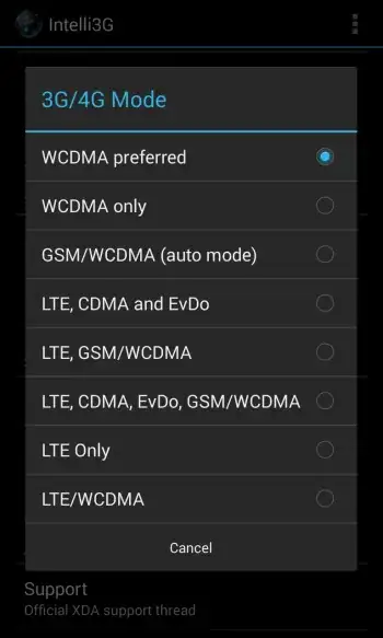

Yes it's possible but you need a rooted phone.
You can then install the Xposed framework, and the Intelli3G module (available on the Play Store or on xda). Inside the app, you can set any combination you want, like LTE/WCDMA which means 4G/3G but not 2G.
Intelli3G modes
